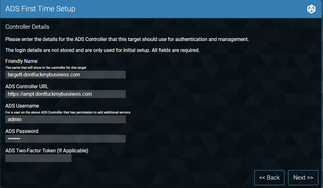

  9. AMP-Target Error Step 3 (Name, AMP-Controller-User-information, domain) picture

Pedi posted this 09 March 2021
Hi,
AMP-Controller: No Logfile
AMP-Target: Only one line
  • [13:00:20] [ADS:admin Debug] : Testing ADS login details against https://ampt.dontfuckmybusiness.com
Controller Details - picture
Mike posted this 09 March 2021
My assessment then is that the target is failing to communicate with the controller at all as there is no authentication attempt logged. Can you wget the controller URL from the target?
